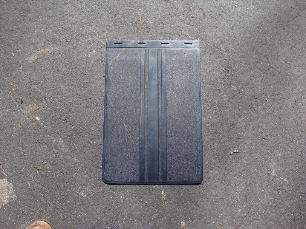

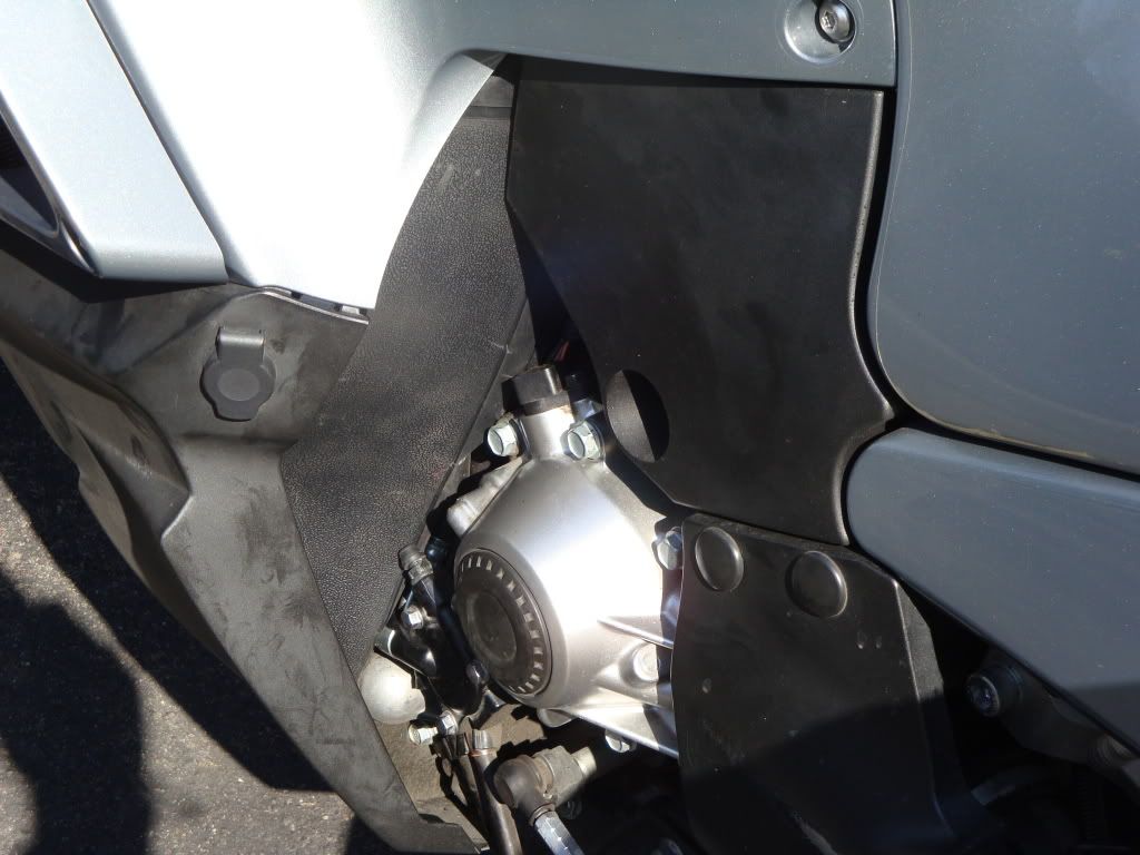

I did before and after rides with same ambient temps. at 60 degrees. Monday (after) I was wearing slacks while riding for work and didn't notice any adverse temp gage affects of the panels. One bar above "C" while riding and two bars in stop and go traffic. As for lower leg heat these panels did keep the heat from flowing out the rear as tested with a bare hand while riding. Enough heat wraps around the louvered faring for warmth in cooler weather.
The true test will come as the temps. near 90. No sign or smell of melting either. Since only one flap was used to make both panels I may refine the shape of the right side to fit the clutch cover better.
Will update as time goes on.
12" * 18" = panel size
Truck & Trailer Rubber Splashguards
These splashguards are all universal fit to most flatbed trucks, trailers, and equipment. They are reinforced to not crack or tear. These universal flat splashguards are also easy to cut and custom fit around unique applications.

大大 你有改嗎?
這是不是只為了不讓騎士的雙腳發燙 |

那降子引擎裡面的熱不就悶在裡面阿???????? _________________ 買肉,GTR |

對丫!會壞掉!

所以 2010 GTR 也是會壞..
想太多了, GTR 的通風性, 比STX 好太多. 熱都會往後走, 如果騎快的話.
STX 的熱是往上飄.

改善熱的方式應該是要相輔相成的吧,10年gtr加裝了防熱墊在引擎之中確實隔絕了人跟車之間的熱,但10年整流罩也做了改變來增加散熱,只是不知道板上有無神人能解答08跟10年散熱情況確實改變多少的相關數據呢?~~ _________________ 買肉,GTR |
